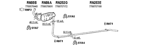

i was going to post where can i get an exhaust system for Matts van (MGUEZ) as it has just failed the mot and my normal trade suppliers were amused by my enquiry although it seems car ones are more readily available
first thought was dutch and german sites malcolm has listed above and indeed reno4er has parts shown as avaiilable
next stop closer to home to avoid postage costs, and Partco motor factors quoted me £94 complete system +vat next day delivery
aparantley made by Unipart
my final websearch looking for unipart direct took me to Online automotive
and unbelievably complete system is shown as available at £77.79
i havent clicked further to check postage costs as waiting for matt to try renault dealers local to him
http://www.onlineautomotive.co.uk/

i have actually got an old Bosal catologue (amongst many other obselete books)as Bosal was my preffered non genuine manufacturer
but when i quoted part numbers to my supplier i was told no longer available
hence my google search as i was sure renault no longer supply F6 bits as tried a few years back (but may depend on helpfulness of dealer cross referencing old part numbers)
thanks for link ,will let Matt decide as have bandaged pipe today to get through MOT !!
