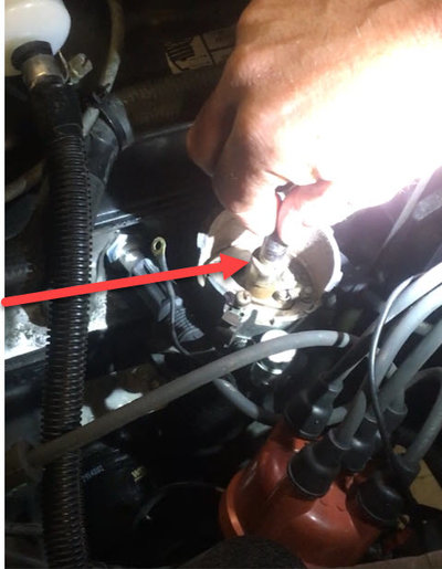

Thanks Andrew. I took it to a local guy 1/2 mail away to look at as after tinkering, I realised i don't have the tools or space in my garage (which doesn't have electricity and is in an unattached garage block). He opened up the distributor cap and saw lots of filings and showed me that the distributor centre wobbles in an elliptical motion (see attached) and recommended a new one. I've read there are different distributors. Would anyone know where i can find one and which type. I have
a 1989 GTL 1108, Engine Number: 688 D7/12 C213003 and VIN: VF11128xxxxx43420. Unfortunately i can't get at the car but think its a Ducellier.
