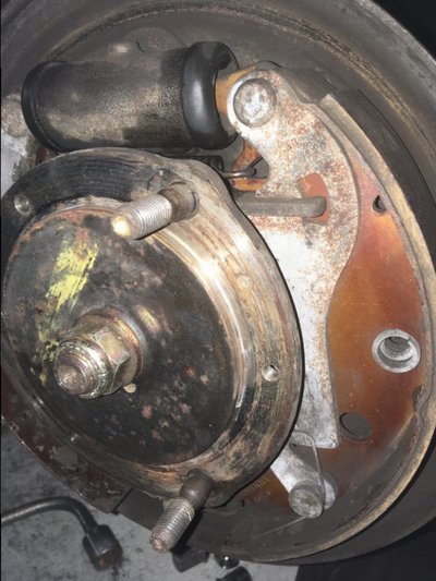

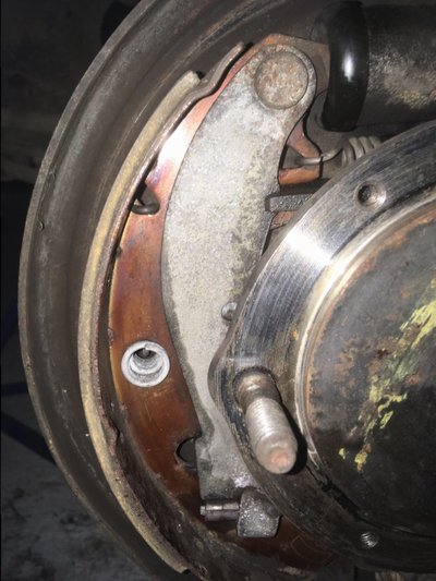

Well, having finally persuaded the drums to come away from the hubs what do I find but Bendix stamped on the brake linings. unfortunately I also found that moving the rubber caps on one brake cylinder resulted in a loss of brake fluid. I am therefore concluding that I need to refurbish/replace the front brakes. Could this be an opportunity to consider swapping the front drums for discs? I would be pleased to hear any info on sources for either option although I appreciate that there are currently considerably more important things to think about.IMG_0114.jpegIMG_0113.jpeg
Consider that you will need the complete front stub axle assemblies, along with calipers and discs, as well as rear drum backplates with shoes, handbrake cables and lever, It's up to you...
......Although the linings themselves look in pretty good shape, with plenty of wear left in them!
These brake liners look fine and you have the auto adjusters on them. Like angel says, you need to change the full brake assembly at the front and move the handbrake to the back. So if you just change the brake cilinders you are fine.
