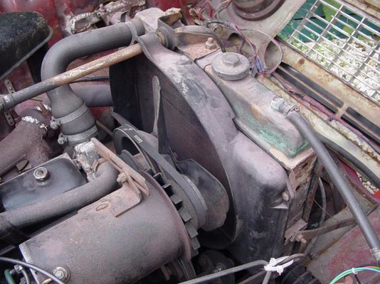

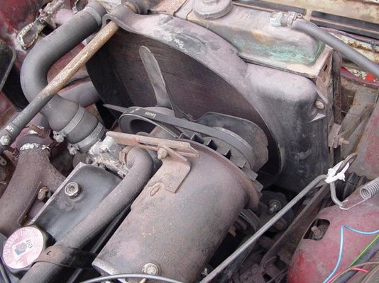

I am looking to buy a fan for my R4 radiator because it does not have one and the weather being a bit hot at the moment I am a little bit worried it might over heat, its a 1971 and which didn't come with a fan, perhaps it would be a better idea to change the radiator for a bigger one with a fan already attached any ideas on which one will be suitable.
Is it the original 850cc engine with the radiator mounted on the steering rack? Those had an engine driven fan which is very effective. Can post one up if you like.
radiator fan
Sorry Malcolm
My head is in a spin today after putting the wrong fuel in my sons car, what I meant to say was I did not think the radiator and fan that is on my R4 was adequate for the car in this weather, hence would it be better to put a larger radiator with an electric fan on instead, if so which one.

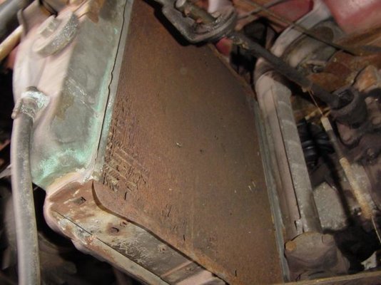

Radiator does look a bit knackered in one corner, but most of it is still there. Is it causing problems?
I don't think I have ever had to replace an early radiator. I've blown the flies out with an air line but that's about it. They can be reconditioned for under £100 and if there is a worry I'd go that route rather than modifying the car as the cooling system on the early cars does normally work very well.
It doesn't really overheat in fact my sons Seicento actually did overheat but I stopped it in time before any damage was done, I suppose I am being over cautious simply because I like the car so much.

Malcolm the bushes are not seeping out and I did trim the edges of them so thanks for that another problem solved, I think I will stick with the radiator that is on and have it re cored locally, perhaps I'm just a born worrier.
