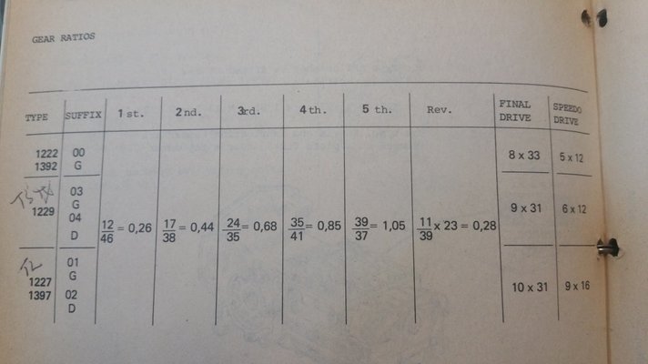

I have just found the workshop manual there is about 3 pages of different ratios listed for the four speed gearbox and will take ages for me to upload pics however as we are discussing 5 speed gearbox here is the info the gearbox we need is HA1 with 02 tag right-hand drive 01 tag is a left hand drive
HA1 03 and 04 is the ts gearbox or tx

We have discussed about ratios in 5 speed gearboxes earlier.
Maybe you will find some interesting info here
http://www.renault4.co.uk/forum/threads/5-speed-gearbox.5784/
I would like to here some "real life" experience from anyone who has 5-speed gearbox with standard 1,1 GTL engine?
If there is one with combination like that!
Are figures that i have calculated real or just math?
So to summarise, am I right in saying that there is not really much advantage to fitting the 5spd box to get a decent drop in revs, apart from the revs decrease, is the R5 box stronger ?
