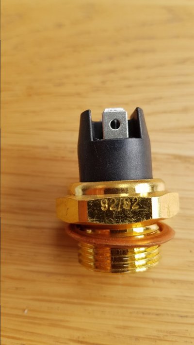

S Simon Knight Enthusiast Messages 189 Location Sawbridgeworth Jul 29, 2020 #1 Hi all, can someone tell me at what temperature the radiator fan should start working please? Cheers Simon,
Andy McGhee Enthusiast Messages 1,543 Location Cheltenham Jul 29, 2020 #2 Hi Simon According to the Revue Technique, the fan should come on at between 90.5 and 93.5 degrees C, and stop at between 80.5 and 83.5 degrees C. There's usually an average (92/82) on the switch itself.
S Simon Knight Enthusiast Messages 189 Location Sawbridgeworth Jul 29, 2020 #3 Hi Andy, thanks for the info, have just fitted a temperature gauge so next time out I can see how accurate it is. Cheers Simon.
