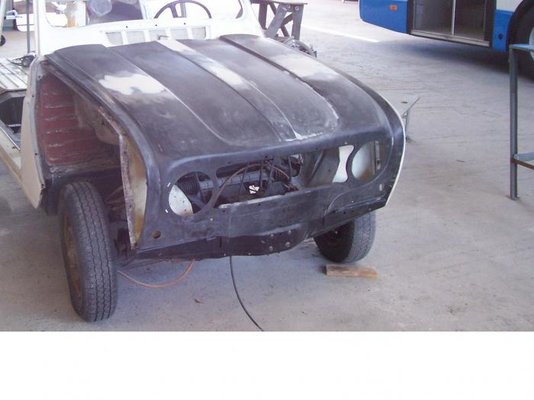

Here is a picture of the Mk I bonnet. There are the main differences:
- the cooling inlet is formed otherwise and contains a pressed grill, which can be (or not) covered by an aluminium decorative grill
- the front part is otherwise pressed in the side areas (between the head lamp hole and the licence number profiling
- the inner reinforcement seems to be another
- the indicator holes are embossed

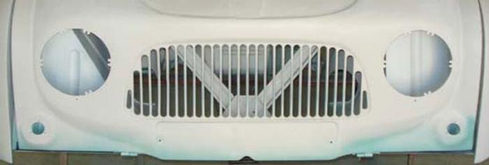

How looks the round indicator hole on the later (Mk2) bonnet? Is it embossed too, or punched flat as on the latest rectangular indicators?
Regards Pavel

Here you are, the bonnet is a new part, but not original Renault, if it does matter. It is flat, unlike the 3-speed bonnet.

as seen on the two previous pictures the newer bonnet has a larger hole but of course if you can weld in new bits it would be poss to mount the first type grill-I thought you meant if the mk1 grill could just be mounted in newer type bonnet... good luck anyways! -R.
i don't think so, the pressing is different. The grille sits lower than the headlamp holes on the early bonnet, and the contour around the headlamps and number plate is also different.
As the headlamp hole centres are (should be) at the same distance, it could be possible to fit the early grille but it would not really look like it should.
