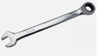

Would a 13mm slim ratcheting combination spanner be slightly easier to use? I think Edwin already has a set from Lidl. 13mm ratcheting combination spanner.jpg

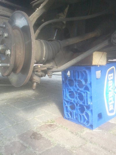

Instead of balancing your car on a log, use beer crates.
They have a multi function;
1. they are a sturdy support for your car
2. the beer is a thirst quencher.
3. invite friends for help and beer.
