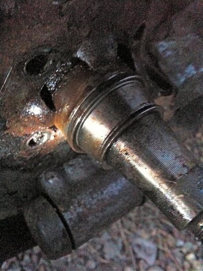

Any ideas on this one? The image shows the rear stub axel with the remains of the inner bearing jammed-on. I've tried heat & a hammer & grips. The bearing lip is so small as to have defeated three diferent pullers. The only thing I have yet to try is a grinder.
Any ideas or previous experience much appreciated

fill plasticbag with icecubes tuck around stub till they melt,heat up ONLY bearing with small torch then pull it off-Works for me...
If Reidar's trick does not work, carefully make a cut across the inner race with a grinder, but not so deep that it would damage the stub axle. Now place a chisel in the cut and give it a good whack, the race will split as it is rather brittle.
