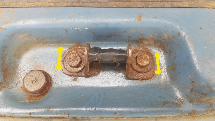

You could try experimenting with the position of this part - it can make a huge difference (the tape helps, too!):

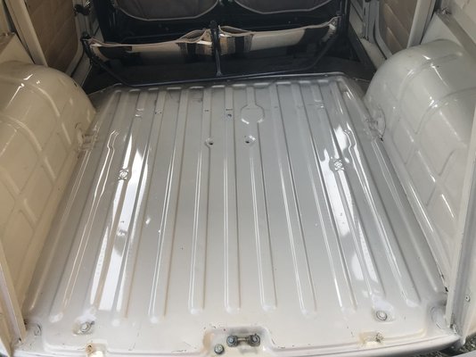

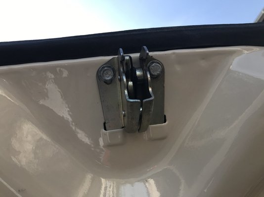

Hi all thanks for all the comments and after removing pretty much everything (seatbelts and rear bench) I tracked it down to the tailgate adjustment. The weather seal is original and will try and rejuvenate with some gummi pflege (have used this before on door seals) or replace it later but it appears to be glued in which might remove paint etc. I adjusted the tailgate lock and the noise is much better than before. So a happy Monsieur here :)
Have you tried to adjust the tailgate latch in the boot floor rather than the lock within the tailgate? You'll find if you loosen the two bolts the latch can be adjusted, so make a tight fit within the lock. You may have to close the tailgate with more vigour, but with the seals compressed and the catch holding the lock more securely under tension, this should significantly reduce or eliminate completely the rattling tailgate.
A little grease at the contact points of the latch and pin always helps. The boot floor and tailgate frame is rather flexy and will eventually squeak, no matter how good the latch adjustment is.
Hi all, I did loosen off the catch in the boot floor but it didn't seem to move hence I adjusted the tailgate lock instead. Will do some work on the seal and then have another go, will also lubricate the lock and see if that helps things. At least I've managed to work out where the noise was coming from, that alone feels like progress :) Thanks again all for the wise words of experience :)
