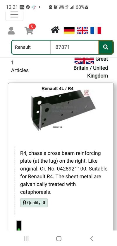

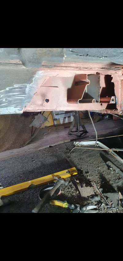

Hi all Im repairing the rear chassis at the moment the photo shows the section cut out but I've actually plated this now Flush if that makes sense in line with the rest of the chassis section. I know that there's also a 2nd strenghtening plate in this area.. the inner face of this rail is in good order so I plan to leave as is.. my question is I plan to fit the re-inforcing repair section over the top next, do I need to cut out the inner section (of the repair panel) as the chassis rail already has the extra skin there intact. I know It would only be an extra plate of a 1mm or so on top but I'm sure I read here about getting this area as accurate/original as possible as it may affect geometry and re-fitting of the rear suspension etc what you think?
