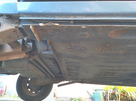

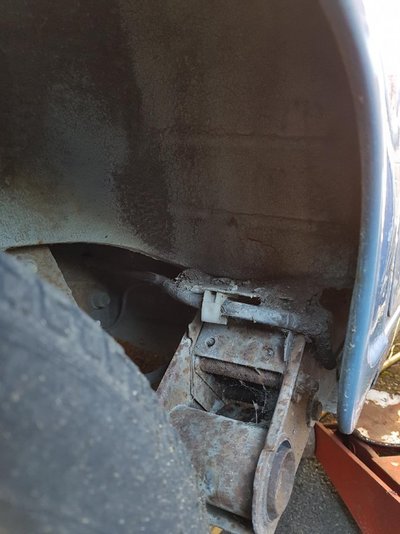

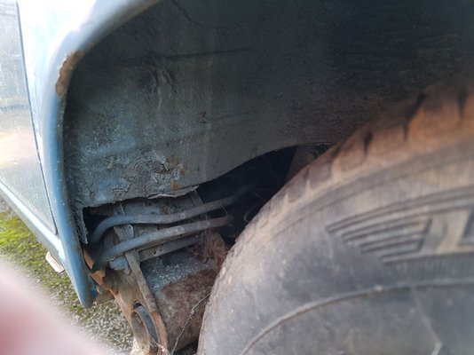

Hi all I'm new here and just purchased my first R4 - this is the condition of the rear chassis outer - how bad do you think it is? is it worth body off or just patching up from the outer?
Any experience and advice muchly appreciated cheers J2017-10-06 11.06.24.jpg im
also floor pan needs a bit of love patch or repair panel?
In most cases it is not possible to see the true extent of the rust without removing the body.you need to examin the rear bush area as per your picture but also the rear legs and front chassis.Removing the body is not so difficult and you will get much better repairs.

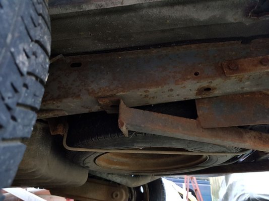

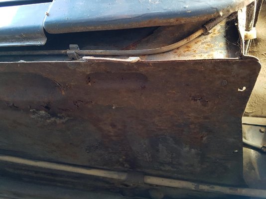

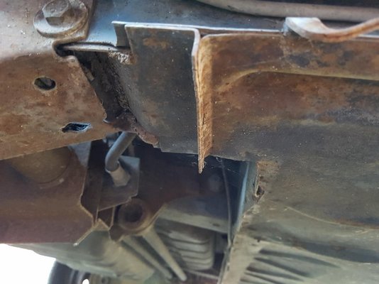

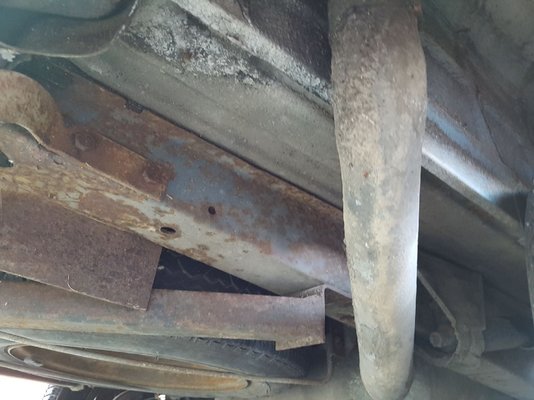

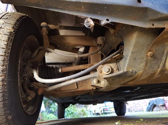

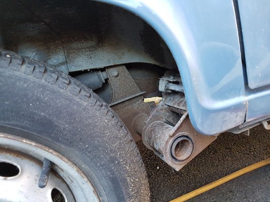

many thanks for your prompt reply - as i suspected - the car is very usable so just need to justify taking the whole body off and it becoming a project. The other areas of the chassis on initial inspection look pretty good...2017-10-06 11.03.38.jpg2017-10-06 11.03.06.jpg 2017-10-06 11.03.31.jpg 2017-10-06 11.06.34.jpg 2017-10-06 11.02.45.jpg 2017-10-06 11.02.54.jpg

agreed - I think a good wire brush down and protection would do the job nicely for now - many thanks for your input - now the grubby bit begins! : )
It's good to see more people re-discover the R4 fun so welcome.
Advise on the rust.... there is a lot of surface rust which is normally easy to cure as mojobaby explained.
But to me there are other signs that on the well known spots the rust must be severe as we all know that the R4 will rust from the inside out.
So in term you'll have to deal with this because to me it's allready a problem...
