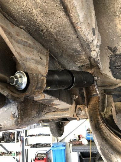

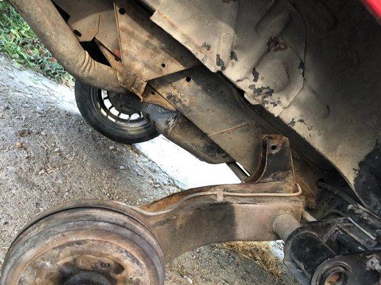

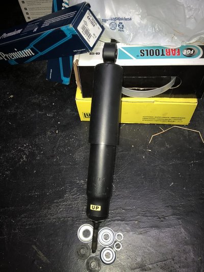

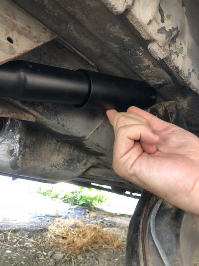

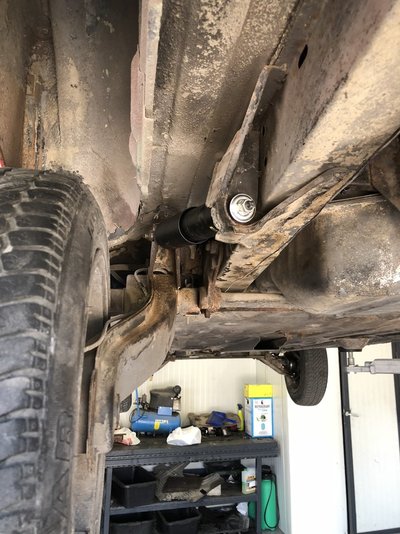

I have a problem with the installation of Kyb rear shock absorbers, upper mount can't fit in ... I lifted arm with a car jack.
Do you have any advice?
According to part number is compatible.
