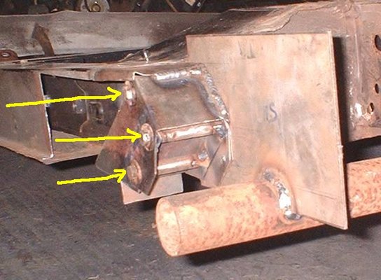

Secondly. Rear wheel tracking. Slacken off the three bolts and jiggle the wheel, as the instruction goes. Right. But I can only find 2 bolts, one on top of the other so to speak (the one shown in the photo on the Clementine repair and one above, hidden in the photo) on the outside of the connection to the chassis. But where is the third bolt to slacken off? I don't seem to be able to find it, or rather, I don't recognise what I am looking at more probably. Help please!
