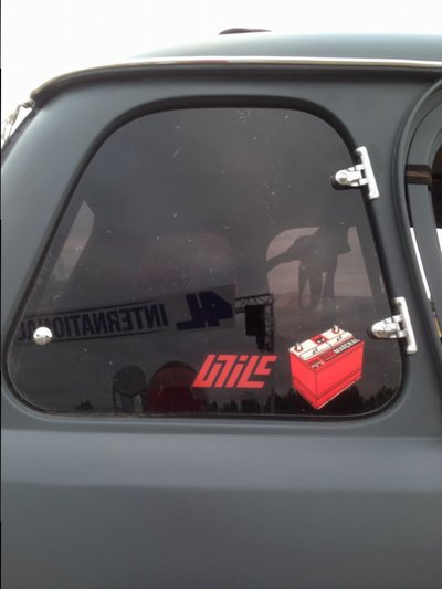

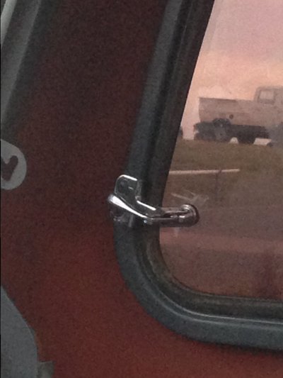

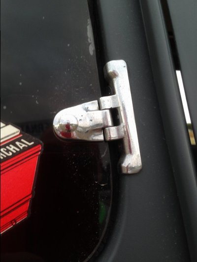

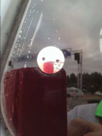

I saw these at Thenay. Really neat. I wonder where they are available from?
Hi Paul. That is exactly what I wanted. Great photos. Now I at least know they exist, and know what I am looking for. I understand the glass is the same, but drilled. Rubber may be different.
Thanks for the info. Edwin
Yes Edwin. There were one or two cars with similar opening rear windows but the owners were never with them even when I returned later. They look very neat and from the sounds of it, very scarce. The search begins eh?
