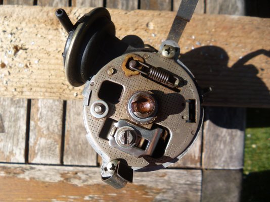

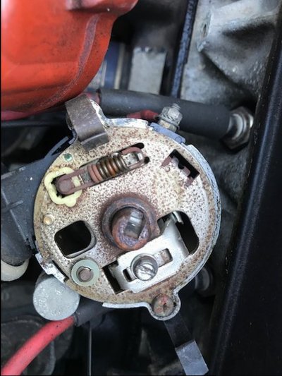

Does anyone know of an electronic ignition kit to fit the SEV Marchal distributor fitted to my 1982 1108cc Renault 4 or has anyone modified another kit to fit. R4 dizzie.jpg
Hi
I may be wrong, but your distributor looks like a Femsa rather than a SEV Marchal. I haven't seen under-the-cap electronic ignition units for these, but they may well exist (probably worth keeping an eye on Spanish eBay). Most people I've come across with Femsa distributors have been quite keen to replace them with Ducelliers, which are much easier to maintain!

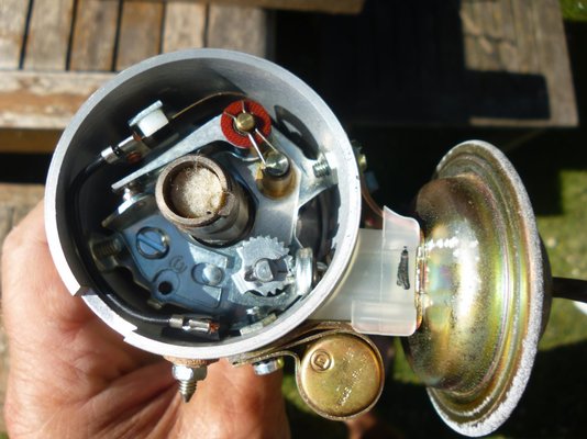

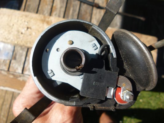

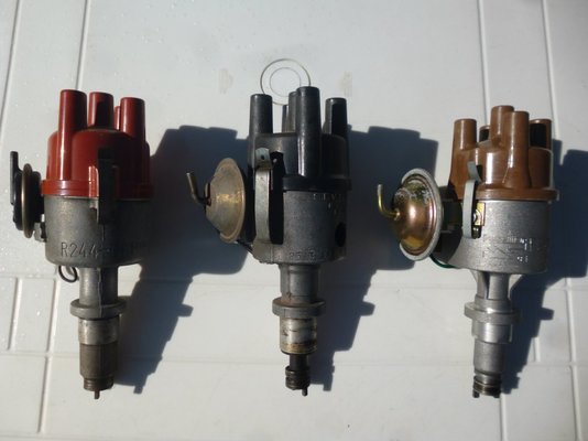

A few photos:
From left to right: Femsa, SEV Marchal, Ducellier
Femsa - quite fiddly to change the points on these!
Later SEV Marchal with cassette points - very smooth and reliable.
Ducellier (not externally adjustable)
A brand-new Ducellier would make a big difference - the Valeo points last for ages!

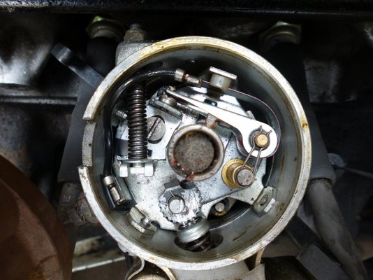

Just one other thought - if the curve on your distributor is R244D61, you might find a Ducellier with externally-adjustable points, as in the photo below. I think they're less under-cap EI-friendly than the normal Ducelliers, but they make any points adjustment very easy, and are extremely reliable. I don't know what the scrapyard situation in France is like these days, but it's worth having a look under the bonnet of early 5s. The early GTLs with the 810-19 engine had this type of distributor.
