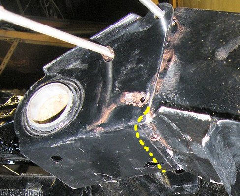

Outer Chassis Bracket
My Outer chassis bracket is corroded, I have seen these on der Franzose website but am worried that it looks tricky with the bushes.
My plan is to try and weld it and if I damage the bush get a new bracket and bush. Are these bushes easily availible and If not which one would it be on the der Franzose website as they have loads of different sizes !
The bracket before removing rust ! (:( hole in the side is about twice as big now)

The rear dampers should extend if they are gas-pressurised ones. So, either driver's side damper is defective (has lost its pressure), or someone had put another one, non-pressurized at some time. Anyway, they have to be replaced with the correct pair. To remove the self-extending one, tie it with wire before removing the damper-to-suspension arm pin bolt, this will stop it from extending.
Replacing the rear arm bushes is a hassle, don't try this before you have read the procedure in the factory workshop manual or Revue Technique Automobile (Haynes does not cover it).

The Franzose bushes will fit the GTL - just need to cut some material from the bottom at the rear of the new ones to clear the bottom of the chassis.
The old bushes need to be cut off which is easy enough with an angle grinder so long as you remember there is a step in the mounting. New ones knock on with a hammer and plenty of lubrication. You need to get the orientation and distance knocked on perfect or the rear suspension becomes difficult to refit so some sort of simple alignment jig could be handy - the bushes can't be removed again once they are on the suspension beam.
Those are the ones. Not identical to the GTL but they fit. They are handed left and right. They are a suspension off job to fit.
Brialliant Thanks, Suspensions already off was trying to work out if there was any way to weld the original without removing !!!
