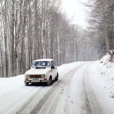

I've got two set of Hankook tyres on mine, for summer and winter.
I drove the car under the snow few times and the winter ones worked quite good.
But the best part with winter tyres is the grip at low temperatures also without snow or wet road, a great help for safety.
(BTW I'm satisfied also by the other set)
Both sets are 145 mm wide.
