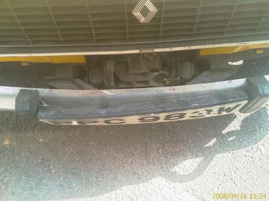

my yellow peril has got 5speed gordini/alpine box fitted (with 1647 r16tx engine !! )
you will need floor change linkage off 5gordini/alpine , crossmember and mounts front hubs discs and calipers + driveshafts ,box is longer but will just fit behind standard bumper ,more info if you need it
can take some pics if they help
anything is possible but realistically no as linkage is much to far forward to connect up
as it comes out past bonnet !!!
