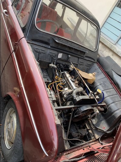

Yes , I think it’s historically important as well , hence I’m doing my outmost to do the best I can to restore this car as original condition as I can yet enjoy driving it . This is the picture of my engine , thanks for the 2 websites i’d Do a check on this and see what I can get. I see this as an important challenge as I feel that this is a really rare car that I need to get it back to much better days . Now I have stripped the whole car to do a total restoration and bodywork ,labelled all the parts and begin sourcing for repair parts . Is there anywhere I can find original paint codes for Super ?

Point taken ! I will keep the engine original , will find repair kits for it , if anyone can assist with this much appreciate as it’s the first time I’ve come across this engine type . Thanks for the welcome !

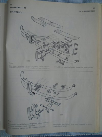

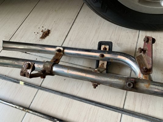

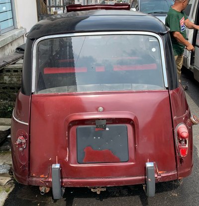

Picture of the back , rear bumper is lost ... anyone knows If the rear bumper is identical to the front ?

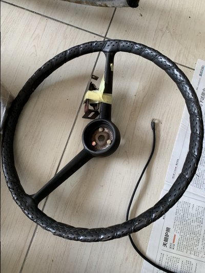

Early steering wheels come up quite often on French eBay:
https://www.ebay.fr/itm/153552032439

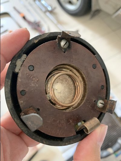

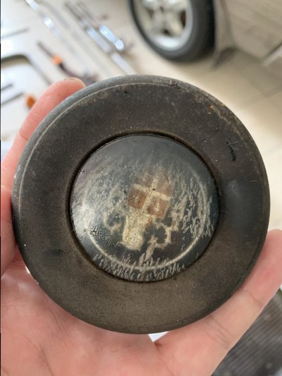

I think the horn would originally have been operated by pushing in the lighting stalk.

Thanks Andy , I will get the workshop manual , for the 2nd site I did translate before that was interesting , for the rear badge it might be the earlier one 1963, the translate page was another type of grey badge which might be 1964. Need to do more homework on that , noted on the horn on the stalk , it’s like the London taxi Austin Fx4 too ... thanks again Andy !’ Just asking , what Renault’s do you own ?
The badge in the Horn looks like an early Austin Mini, or A35, as does the steering wheel come to think of it. So to me looks non original.

If there are any original bumpers left, they'll probably be in France. They're incredibly rare, though, and will be very expensive - not to mention postage costs! Will let you know if I find one.
