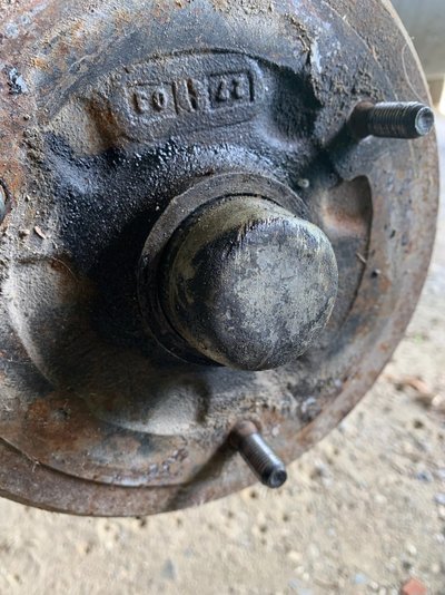

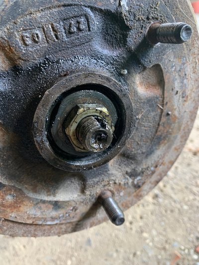

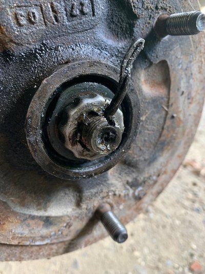

Thanks for your advice Q plate. The right hand rear wheel had a bit of play in it and to be honest it felt the same as the left wheel.
So I jacked the left wheel up, took off the grease cap, split pin and castellated nut and then found the wheel nut, which I tightened by 1/6th, There is now no movement at all and the wheel turns freely as well. So, all good, thanks for your help. Posted a few pics to show the procedure in case anyone needs to do this.IMG_0239.jpgIMG_0240.jpgIMG_0241.jpg

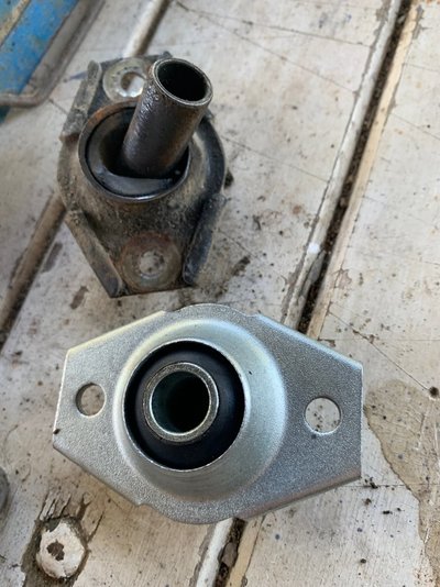

Today I started on the work that has to be done for my MOT.

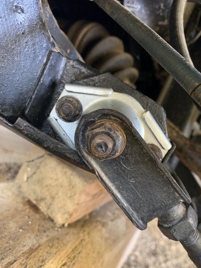

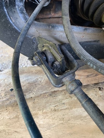

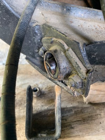

The part that had to be replaced is called a swivel bearing (according to the Haynes manual). The part was really shot as you'll see in the photos. Thats why I don't ming having a roadworthy every 2 years-because they pick up on things that I don't see, and I can fix them before they get worse and potentially dangerous!
To get to the swivel bearing, I had to remove the tie rod first. Am I correct in saying that the tie rods purpose is for the camber of the wheel? There is an adjusting nut on the tie rod which I didn't touch as the tie rod came out quite easily once the bolts had been removed.
Have nothing to do with camber. It's a reaction rod that taking the forces introduced to the double wishbone suspension under acceleration and braking.
Altering its length has an effect on castor angle.
I read in the Haynes manual that pre '69 cars have a 7 degree castor and post '69 have 13 degrees. I presume thats a positive castor like a bicycle front wheel. Thank goodness I didn't touch that adjusting nut. Thanks Angel
