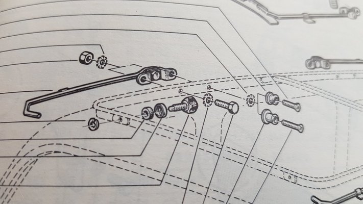

Andy, I think the clip shouldn't work on a regular screw, mine has some brass knob to catch on...

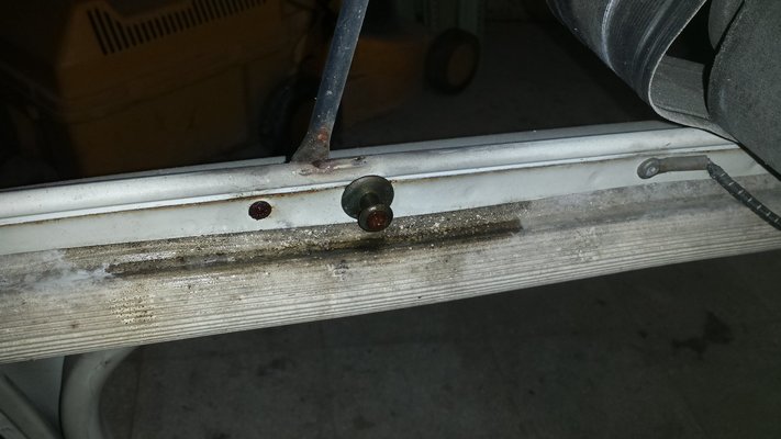

I wondered about them, too - but I think they're the original (1972) fixings:20201120_100136.jpg

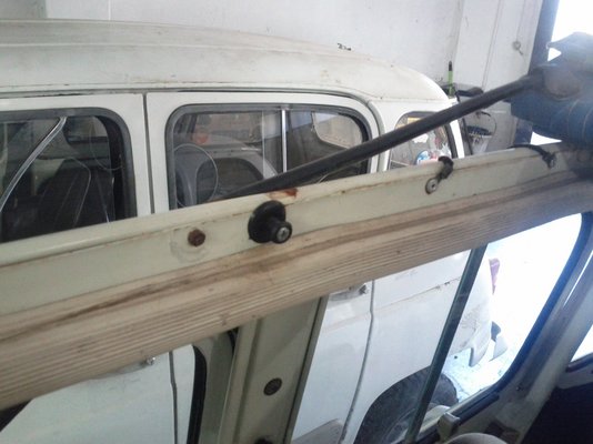

I'd be interested in seeing photos of your car's sunroof!

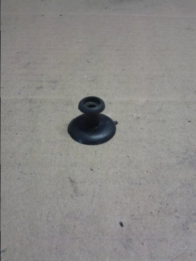

Here it's how this pin looks like, at least on later cars. Does anybody have pictures of this part on a pre-72 car?
Thanks, Angel (and Andrea) - it makes perfect sense now. The 'pins' have broken away on my car. Did you say you had some spare ones?
I remember I bought a handful of them at a parts shop some years ago, but i only found one spare, the rest of them should had been the ones they are on my Jogging. I'll look further in my parts inventory :-) but if I can't find more of them, I can make them fairly easily.
