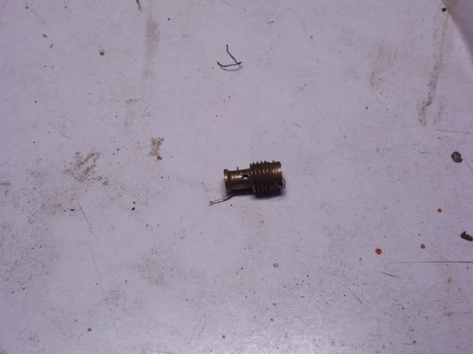

Here is an old trick done here, when it was realized that 28IF jets were unobtainable and the R4 had to pass the (new back then) emissions test.
By threading a fine copper wire (from an electrical cable) from the jet's side holes through the metering hole, and wrapping the ends around the jet, as is barely visible on th photo, you can effectively make the jet size smaller, without having to solder and re-drill the jet. You will need special-and expensive-jet drills to do this job with success (as normal drills are not as accurate), so you can try the wire technique with no cost and hassle.
You can also try lowering the fuel level a bit (0,5-1,0 mm may be more than enough) by using a thicker sealing washer, or adding a second one, under the float needle valve.

Angel, what a great idea!, I ride old motorcycles and thought I had heard all the tricks for repairing and tuning them, but that's a new one, I'll give it a try.
