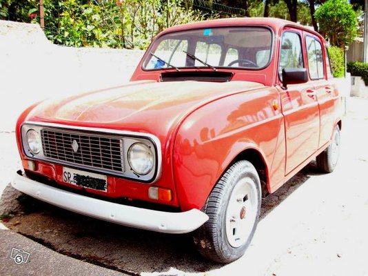

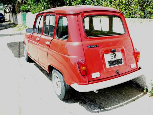

I know I don't write much here, last one was about dampers. Never got to try them out as my 1991 TL died a hard death last week and I sadly miss her as she was my first R4. She made me a R4 lover forever, so today I bought myself a lovely red 1989 956cc. Probly paid to much, but driving my wifes Subaru this week just isn't the same. I've attached some pictures (hopefully they show up) . Just want to say Thanks to the forum and members for keeping this car alive.

Very nice! I am puzzled with the white grille, was it painted or does it seem to be its actual colour?
What happened to your '91 TL?
Hi Angel,
The grill is actual just a normal grey one, the sun shine in the picture is making it look white, but I'd would rather have a black one. My TL gave her last breath trying to get me home from work, I live on the side of MT Etna and while going up heard a tapping noise come from the engine, while looking for a spot to pull over she just lost power and quite running. Tried to start again and all that happen was a alot of grinding/banging for about 2 seconds then nothing as she ceased up. Got her towed to the mechanic, after telling him what happen he said that I run her without oil, which after checking he said no that's not the problem as she had the right amount of oil. But, to make a long story short, would have to replace or rebuild this one and the cost was to much to justify, as she needed alot of other work beside the engine. Like I said before, driveing something else isn't the same, so once I found this one, bought it the same day.
The bodywork on your new car is excellent and I admire your alloy wheels you must be delighted. This car should heal your sense of loss. I am jealous of you and Angel with all that wonderful sunshine - the rain is pouring down here and expected for the week ahead.:)
Que Belle macchina!! (or something to that effect)
Congrats to what looks to be a very good buy-regardless of price! and that Rosso-paint isnt making it look half bad either. -R.
What a gorgeous looking car - congratulations! I am sure you won't regret the cost.

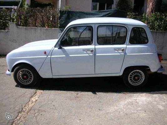

Just to let everyone know, the guy I bought mine from also has this 1985 950cc for sale to, a little more expensive than mine though 3,700.

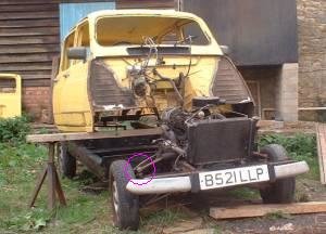

Thanks for the quick reply, since she still up in the air so had my wife wiggle while I felt around and the only movement that I felt anywhere was where I put a circle on the picture.
Sorry, Ermintrude please don't get me for any copy right protection for using you as my display model!!!!!!!!!!!!!!!!!!!!!!!!!!!
There is also the track rod balljoint in the circle :-)
There are three points of wear there: 1.The ball joint itself (you will feel the play on it) 2. The track rod inner balljoint (you will feel the play in the rack gaiter) 3.The rack nylon bush, you will also notice the play in the rack gaiter. Better remove the gaiter to check if you notice that the play is coming from the steering and not the upper balljoint.
