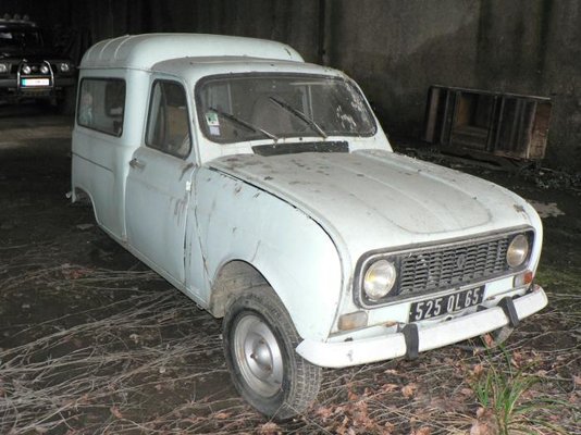

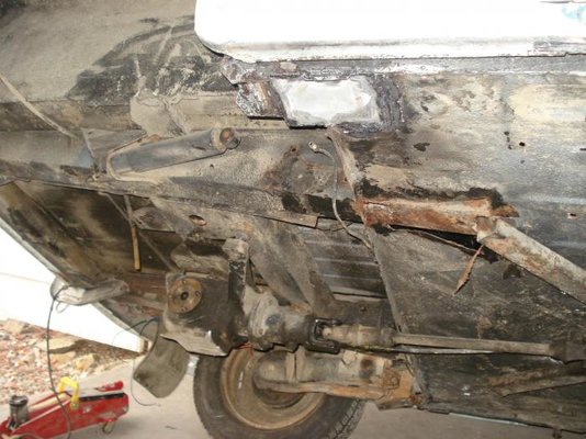

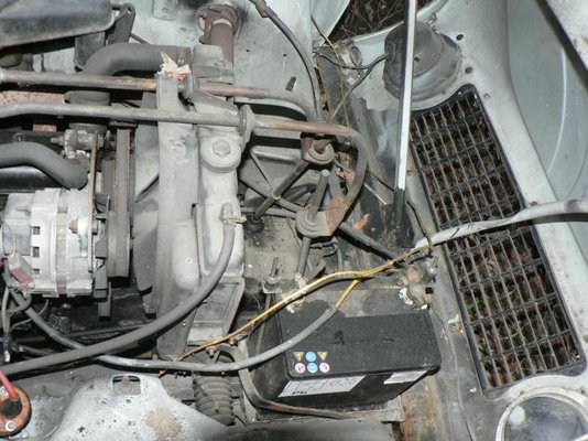

I am rebuilding a '78 sinpar F4 at the moment and am missing one or two details, mainly the wiring associated with the transfer box and rear diff (there are switches which light up dash lights when engaged) My diff/tfr box are actuated by a single dash-mounted lever. Has anyone got a similar model and can take relevant photos ???? I am in the S of France and they are rare here, so maybe its a long shot ..... Thanks Simon

Many thanks , and some great photos . My van is an R2106 as well but later, so there are detail differences. On the transfer box and diff there are switches but no wiring or warning lights - like yours. Maybe switches were fitted but never connected ! I have a sinpar parts book and operating instructions - is that the same as you have?
Thanks again, Simon
