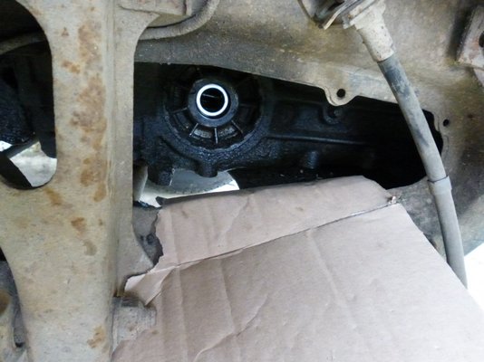

Just ordered. Also found earlier thread re doing it without special tools. But what about pulling it back in, or will it just slide on?

Cheers Andy and others for input. All done easy peasy (nearly except for whacking my finger). No special tools needed!
