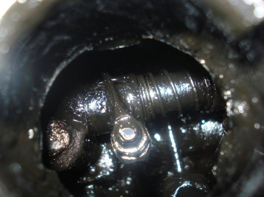

Thanks for the reply. My 4L runs continuously for about 5 years, it has just stoped the last 3 months for some repairs in the painture. I've noticed the sludge in the engine, and would like to fix it. I post a photograph for you to see how it is. Does it look very bad? I'm using the 4L now...

black death
on your picture you can see the hole on your rocker arm on the left is open and clean so you dont have an internal problem - so no need to worry - also dont wash all that gunge off it will go down your push rod tubes and block your oil pick up then you are in trouble - just change your oil more often - it will clean itself slowly. i feel qualified on this subject i started at renault main dealers in 1969 lets say 2 oil changes a day for 40 years i will let you work out how many that is, its a bit like a shiny black chassis - looks very nice - but its whats inside that matters especialy at the front where the chassis legs fasten to the floor pan - you need to look inside - either use a camera or cut it open - so i dont think you need to worry about your engine - 7 out of 10 have a bit of gunge
reg
I'd say the same as Reggie, I'd never use a flushing agent in a clogged up engine, it will cause you more trouble than you think! It will loosen all the gunge and it will end up blocking all the oil ways!!
On the one and only car I did this too, it had had lovely oil pressure for a 200,000 mile engine but I decided to pop a bottle of engine flush into it before a service, ever after the poor things oil light would come on at tickover and as it was a Volkswagen it had a nasty little buzzer to remind you too!
Never ever again for me.
