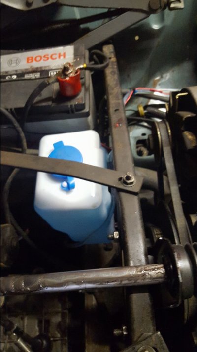

I'm thinking that I might actually install an electric pumped screen wash just to improve safety, has anyone else taken this approach

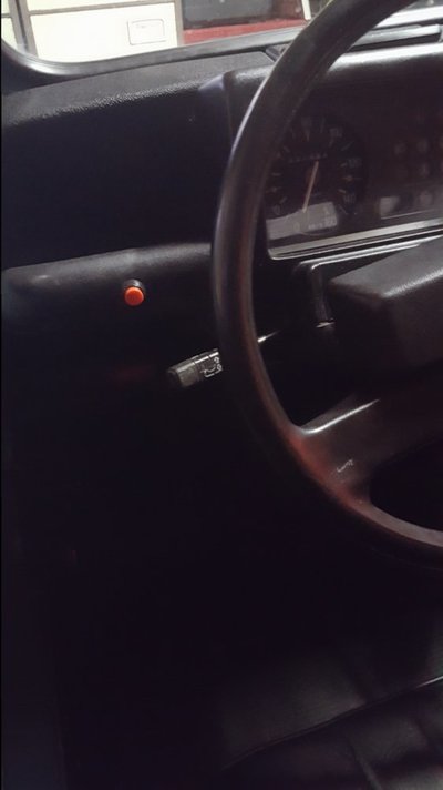

Ordered a washer bottle kit from amazon, was about £13 replaced the original washer bottle with the new one mounting it in the same location, ran the new pipe upto the screen, removed the air flap and installed a new twin jet, this was a bit fiddly, the kit only came with a short red and black wire, earthed the black wire and ran a new red one up to dash, installed the supplied red push bottom to the left of the steering wheel on the shelf (I'm left hand drive), ran the live feed back to the fuse box and connected it to the wiper circuit as the pump was very low power. Job done.. Must say it's a lot better than the foot pump and washes the screen a lot better. I've left the foot pump and pipe in place for authenticity... #busysunday
