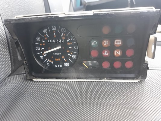

Try as I might I just couldn't detach the speedo cable from the gearbox, so I unplugged it from the speedo and jacked the car up. The cable turns when the wheels turn, so the gearbox end is good (phew). That means the speedo is at fault, will remove and have a gander. If up the spout are there still companies that can repair them, or does anyone have a good second hand unit for a 1987 F4 please??

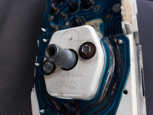

Speedo removed and connected to a drill. The needle doesn't move until the drill is at some speed, then jumps up to about 40 to 45. Clearly in need of attention. I suspect it will be cheaper to find a second hand one than get it repaired? The circuit ribbon on the back is starting to come apart too.
The needle shaft may be tight on its bushings. If you feel competent enough, take the instrument cluster apart and spray a little WD40 there, working the needle back and forth until it it feels free.
