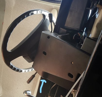

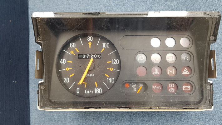

As your car's an 85, I imagine it has this type of speedo:
You need to remove the undertray first - once this is done, you might be able to get to and change the bulb(s) without removing anything else (I remember changing these bulbs once or twice without having to take the speedo out):
If that doesn't work, there's a good guide here:

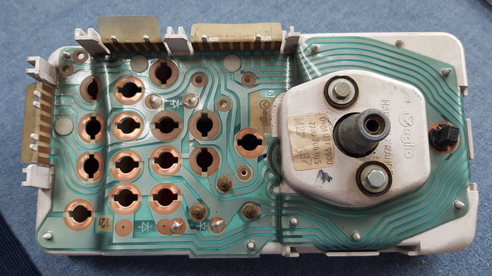

Andy, thats great. thank you. I assume the middle photo is the rear of the speedo, which in my case will still be attached to the car. I will have to lie on my back and thread my hands through all the wires and cables and find which bulb needs replacing, Any suggestions which one ?. With the bulb not working, I dont know where or what it is. I anticipate that it is somewhere giving an overall background light to the speedo display . Or is it the one immediately to the left of the speedo and to the right of the eight warning lights? This is so helpful. Thank you. I could not see it in the car handbook or Haynes, or the Renault Maintenance book I have.
There are two bulbs - one either side of the speedo cable. The photo I posted is of a Veglia speedo. The one at the bottom of the la4LdeSylvie is of a Jaeger - slightly different, but to all intents and purposes the same.
If both bulbs seem to have gone, (no instrument panel illumination), check that your offside sidelight and rear light are working. If not, it'll be a fuse (#8, counting from the right). Much easier than the bulbs...
