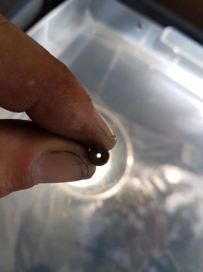

However - Jet was nice and clean.

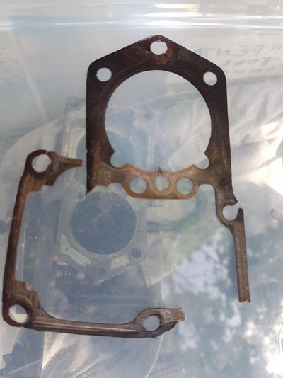

the gasket had a slight tear, which separated at the slightest touch, bugger - and my full set of r4 gaskets.. .. has no replacement.
more hmmmm..
will try and cut myself a replacement from a sheet of gasket paper.
so .. ..
apart from having to fashion a replacement gasket, the carb looks good.
Anything apart from the main jet?
1 cm of fuel in the float chamber is a bit strange. Normally they are full to near the top. Maybe it is that fuel is not getting in.
