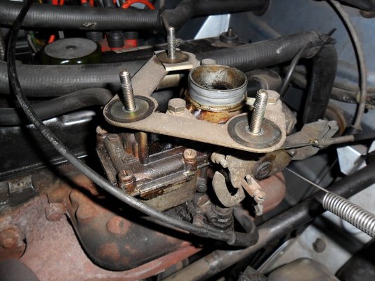

Thanks Steve, you're spot on :) Zenith 28IF. Do Renault supply gaskets for these still?
You were right too about how dirty it is down there. It seems like oil is being sprayed around?
Thanks, Jonathan
Not sure if Renault still do the gaskets but you could first try the 'Carburettor Exchange' in Leighton Buzzard (Google them) and phone them to find out. They have helped me with parts in the past. Do get an overhaul kit and do a proper job. The carb is as gunky as I would expect. That will all come off by cleaning the parts in Cellulose Thinners.
