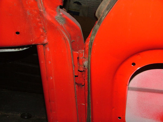

Hi R4 friends,
before I´ll crush somewhat: have you any idea how to dismount the later model door? Simply knock out the plug upwards? Many thanks
:p Pavel
Do not remove the pin,4 nuts on each door a 10mm socket and a short extention and all four doors will be off in half an hour.
If you put a blob of grease in the socket you are less likley to drop the nuts from the rear doord down inside the door pillar.
Hi guys, thank you very much for the good idea. I took almost a grinding wheel to remove it...
