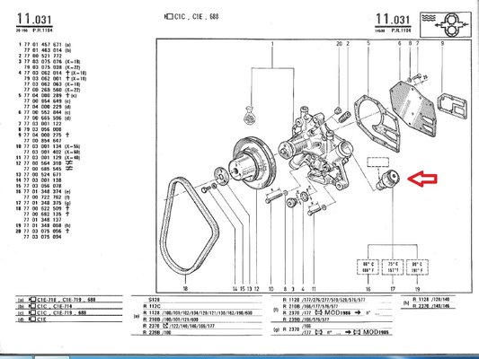

M MartinA Enthusiast Messages 102 Location Devon May 26, 2023 #1 Hi which way around is the thermostat fitted in the top water hose?
JdeW Enthusiast Messages 916 Location Laarbeek The Netherlands May 26, 2023 #2 As an instructor for 30 years I learned "There are no silly questions, only silly answers". The red arrow shows thermostat for Billancourt engines. This picture shows thermostat (red arrow) for Cleon engines.

R reidalpine Enthusiast Messages 1,658 May 26, 2023 #4 Valid question as my thermostat were installed the wrong way (by a "pro") -as a result the headgasket blew few years ago..-R.
