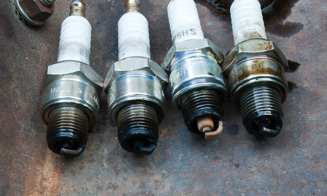

Along the way, I noticed that all the plugs except no.2 are horribly fouled up with an oily deposit.
It is probably just a coincidence, but plug no.2 is an NGK, while the others are BERU. This shouldn't make any difference, I just thought I'd mention it.

Your NGK is a BP5HS... I have 4 NGK BP7HS on my r4, on advice of the shop guy. NGK site gives for our engines BP6HS.

The BP5HS is too hot-especially for a GTL. That's maybe the reason for it being so clean. Are the rest of the plugs of the correct grade for the engine? Plug reading can be very misleading if they are not suitable for the engine!
Champion list the correct plug for the GTL as L92YC and I used these in my GTL for 70,000 miles without any problems. The NGK equivalent is BP5HS.
Compressions don't look that bad. I'd not bother rebuilding the engine on their account. Well worth checking tappet clearances though after a long high speed trip with no additive.
I'd try some BP6HS plugs - those are what I've always used. If one plus was running much hotter than the rest then you might well have been getting pinking in one cylinder.

I've been using a BP5HS plug because as Steve says, it's listed as the equivalent to L92YC. I do have a complete set of BP5HS somewhere, but only put one in because I'd cracked one of the otherwise fine BERUs. Nevertheless, I'll get a set of BP6HS and experiment.

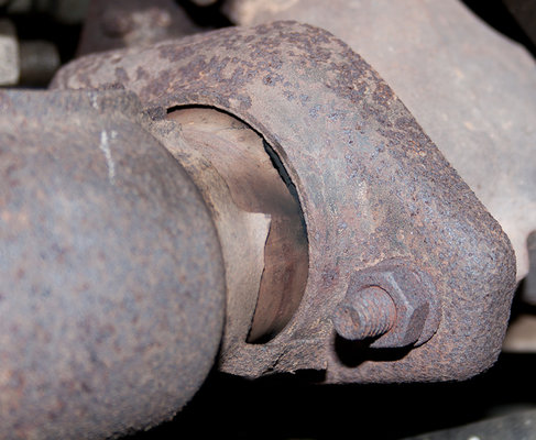

It did reveal a brand new crack in my exhaust – see the photo below. Not a new worry, since I knew I'd have to replace the entire exhaust very soon anyway. It's literally falling to pieces.

What about the crack on the exhaust pipe? Did you fix it? It may well be the cause of the noise. The same gos for a leaking exhaust manifold gasket.
