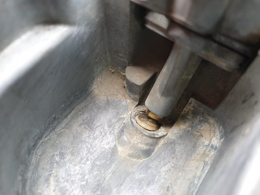

Normally if you need to use the choke to keep the car running when warm it's going to be a blocked main jet. I don't remember if the photo is a Solex or a Zenith but in either case the main jet sits at the bottom of the float chamber.
I think it's a Zenith. I had to pull the carburettor off for access to mine. There is a brass plug in the float chamber that needs to be unscrewed to access the main jet. Once the plug is removed the jet comes off with a screwdriver and it's not a bad idea to drill it out with a 1mm drill bit while it's out to better run on modern fuels. For the Solex the plug is more accessible and the carb doesn't need to come out.
The mixture screw is more for idle and just off idle. I normally have them 1.5 turns out from fully in.
Yes that's my carb in photo
Ive had the jet out and it's clear, I guess I best look again, what I can't do is drill it!

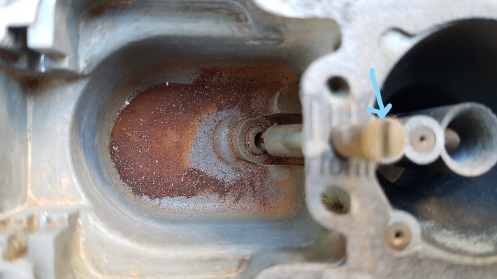

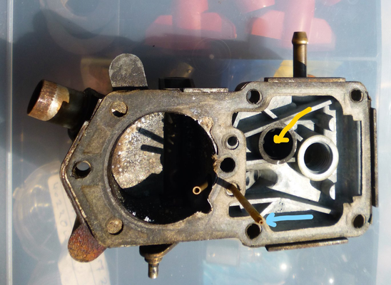

I'm not sure whether you've already done this, but it'd be worth double checking that the jet with the blue arrow is clear - they often get gummed up. I've found a piece of soft electrical wire works well.
The filter under the 'doorbell' often gets blocked too - worth a few squirts with carb cleaner.
Good luck!
Ditto for idling jet (the hole in the bottom often gets blocked)

I was thinking of checking that, it's the idle jet of course, mind you that would not explain the need to run rich would it?

Sorry is the. blue the idling jet?
In the second picture, yes.
I had a similar problem with my TL - the long tube in the first picture turned out to be blocked. The Autobooks manual calls it an 'enrichment device'.

The second picture is not the Zenith 28IF though

Hi everybody not been on this forum much for a while on the top of the carburettor there is a metal domed cap which has a mesh filter underneath there is a tiny rivet holding it on which will need carefully drilling out when this is completely blocked it stops any air getting into the float chamber meaning you need to pull the choke out to compensate
Hi
My dome was missing too. I found a copper end cap in the plumbing section at B&Q which was a perfect fit. All that was required was to drill a small hole in the top to secure it in place.
