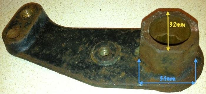

Geoff, is the anchor lever on pre-69 cars octagon shaped, too? Can you measure the AF distance, to check if the tool will also fit these cars?
Yes Angel, the early ones are octagonal. Across the flats it is 32mm at the narrow end (yellow) and 34mm at the wider end (blue).
