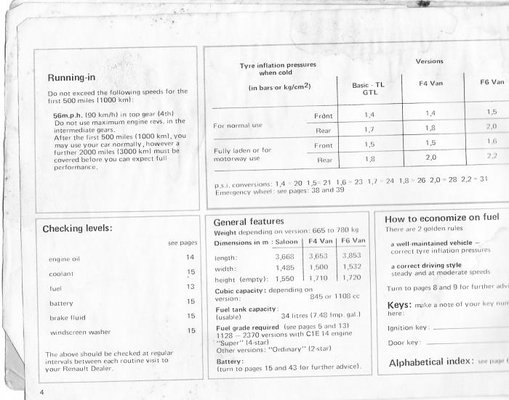

Hi All
Can someone tell me the recommended tyre pressures for standard fit on 1984 GTL?
I don't have a handbook and not in Haynes.
Thanks and Happy Easter!
Mark
Thanks Steve
Like to conform sometimes!
The man at KwikFit blew them up like balloons!
Cheers.
Mark
I prefer them a little higher pressure than the manual suggests - I think tyre technology has altered since they wrote the specs. To me 20psi feels under inflated - about 28psi all round (1.9 bar) suits me for a GTL.
Thanks Malcolm
That was great advice - very good ride as you suggest:)
