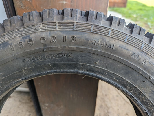

Sadly Goodyear doesn't produce them anymore but you can still find Goodyear 135SR13 rally tires on leboncoin

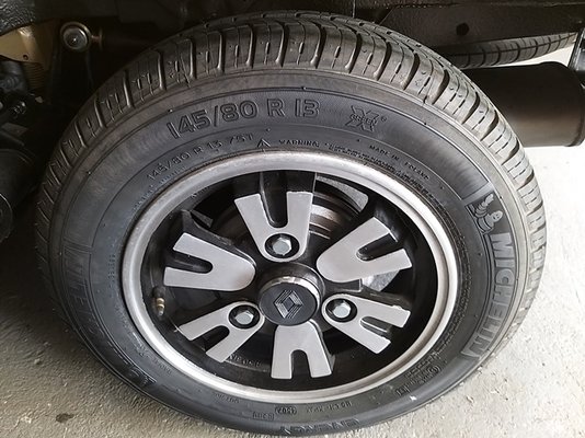

Thought I would check Noddy's new tyres, and he is fitted with Michelin 145/80/R13's. Although I was a bit shocked when I checked the manufacturing date on them was 2007 ! And probably fitted when he was restored. And even more shocked that the new Michelin price of these is now £168.00 each !
They recommend that you should change tyres after 10 years, but I won't bother as the walls are not cracked.
