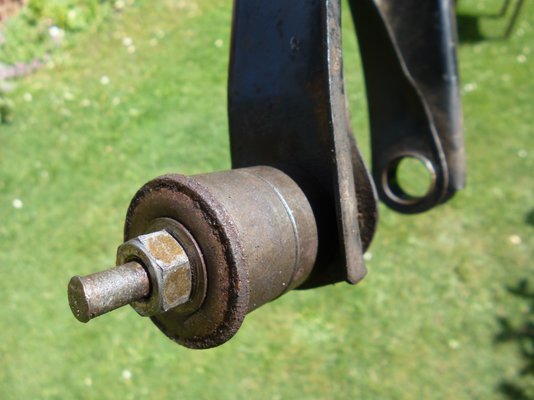

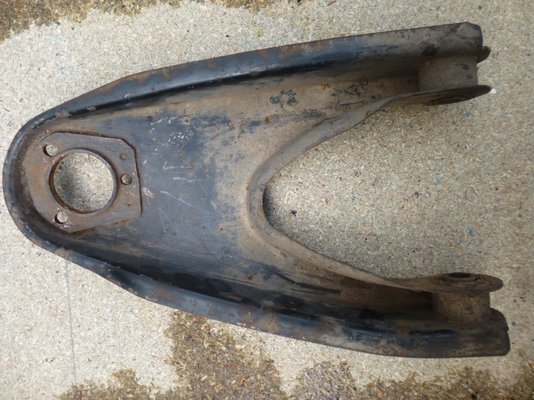

Last summer I was investigating what I thought was a tracking problem (slight wear to the outer edge of the O/S front tyre), when I found a bit of play in the upper wishbone.This turned out to be the cause:

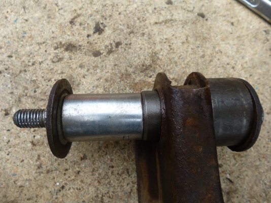

I'm not sure what methods you all use to change the wishbone bushes, but this works for me (note the R4 front hub spacers!):

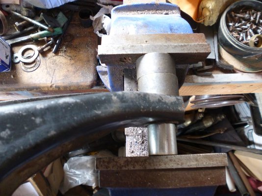

Although it's easier with a vice, I find this kind of tool (or variations on it) pretty effective, both for removing and replacing the bushes :

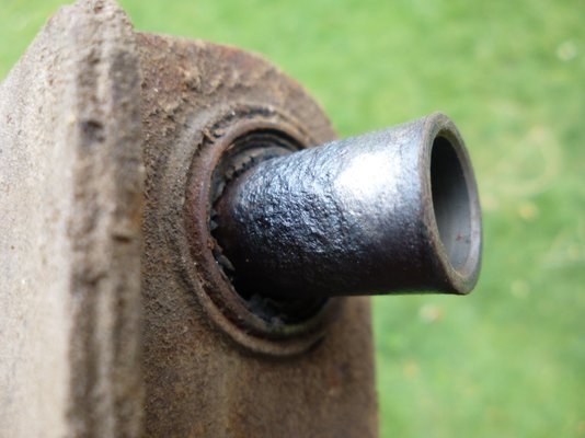

This particular bush was pretty reluctant to come out; I found it easier to remove the central ring first:

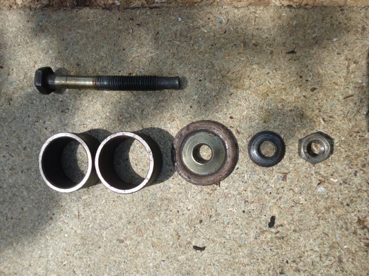

Pushing the new bush home:
All much better now - it seems to have sorted out the tyre wear problem.

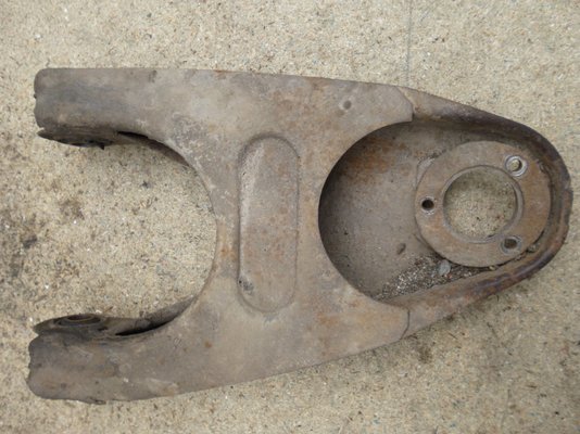

And, just out of interest, pictures of a GTL wishbone and the reinforced ones fitted to F6s (do F4s have the same ones?)
GTL
F6
