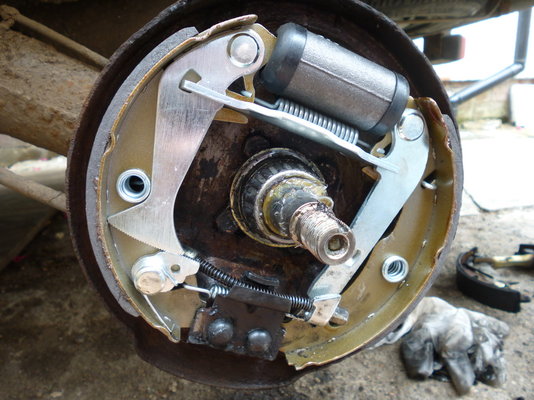

This is the Bendix system on my GTL (is yours a GTL?)

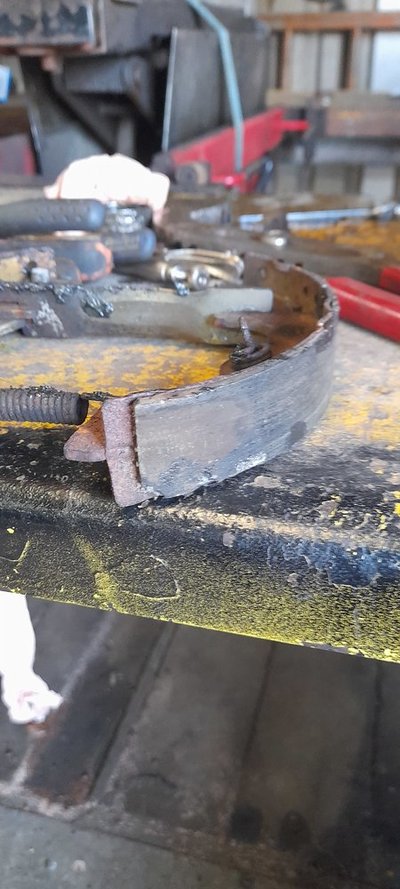

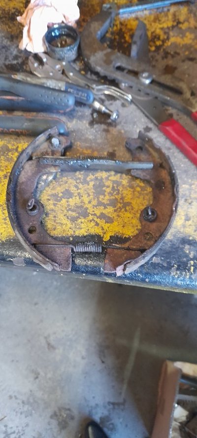

Here are images from the mechanic, I have found with EUspares a TRW GSK1011 EAN 3322936600350 for 74.72, or I have also seen a Brembo Kit and Fit K68011 EAN 8020584076538
Do you think either of these would fit? I was told that I need it to be only 1 lever, bendix with cylinders

If your car had the self-adjusting Bendix brakes that most of our GTLs have (like the ones in my photo and the links you posted), it'd be easy to find the parts in the UK.
It looks from the photo as if your rear shoes are not self-adjusting - do your rear brakes have the square manual adjusters on the backplate?
For 180 drums - which I imagine your car has - the PR900 parts book gives the number 7701202923 for shoes (not self-adjusting). These shoes were also fitted to some 5s and the R1181 R6.
These are on eBay:
They match the part number, and seem to have the right holes in the right places - if you send the link to your mechanic, he'll be able to decide.
He'll also need to measure the cylinders - if they're 22mm, there are plenty on eBay. For example:
