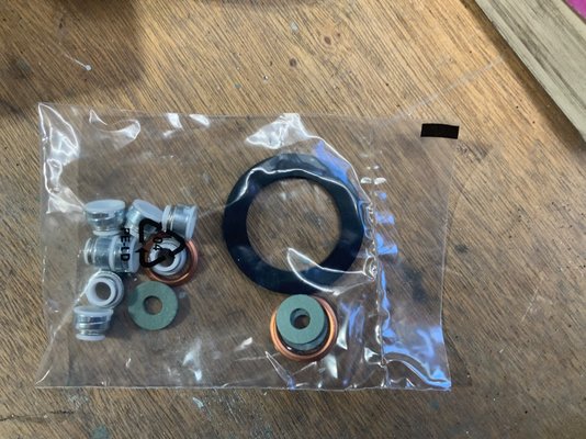

Just about to refit my head (‘85 GTL 1108cc, 688).
So, taking it apart, no guide seals. No problems at all there- very Renault.
However, just received my gasket set from Der Franzose and there are seals in the set…
Would I be right in thinking these could be for a later R5 spec motor and they are chucked in the bag anyway?
They look like they just have an external spring clip to hold them on the guide, so no crooked on the guide.
Should I stick them on anyway?
with my large engine overhaul order from the Frenchmen the valve guides where present but I didn’t install them.
There aren’t any factory installed
