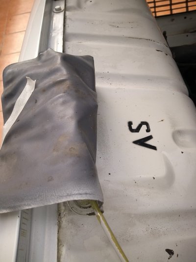

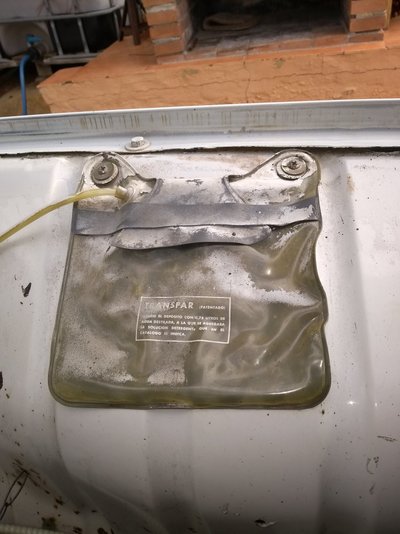

Hi guys . I have a 1972 Spanish built 4s . Is this the correct washer bag and if it is then how can I get a replacement because mine is split . Does anyone know what the SV painted under the bag mean .

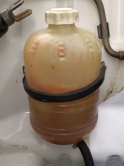

I have swapped the expansion tank from IMG_20191229_151200949.jpg IMG_20191229_151035400.jpg IMG_20191229_150938320.jpg a 1982 4 GTL because mine was split so will it be ok as I had to keep the GTL top with it .

You can get a replacement washer bag here:
https://piezasautosclasicos.com/bolsa-agua-limpia-parabrisas-renault-4
They have loads of other parts that are hard to find in the UK. They're bound to know what the SV stands for.
If your car originally had the glass expansion chamber, there's one here:
https://www.milanuncios.com/recambi...la-expansion-renault-4-5-6-8-10-295614061.htm
Thanks for the info . My expansion tank was the same as the one in the picture but with a different stopper which may a different pressure rating . As far as the washer bag is concerned the site you gave does have the bags but I need to ask them about the SV .
Thanks again

My 1972 R4s had a split radiator expansion tank so I swopped it for a 1982 GTL tank that I had available but could the screw caps allow different pressures to build up because I am having cooling problems .
