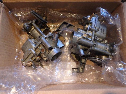

Few days back i have received small box with treasure inside
two completely refurbished, tested, and pre-adjusted Zenith IF28 carburetors.

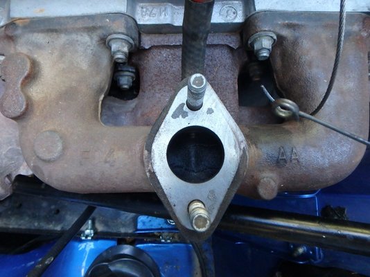

Yesterday spend all afternoon to change it
Old one
removed......notice big soot deposit around carburetor stand.

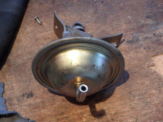

Also managed to get vacuum pump.....used but in good condition

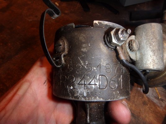

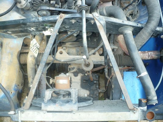

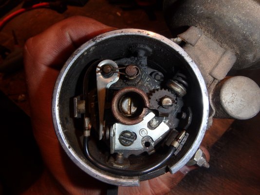

Taken from this distributor
Inside
Cleaned in diesel
Adjust point again and started engine adjust idle little bit
Went to my friends garage for fine tune with strobe light.

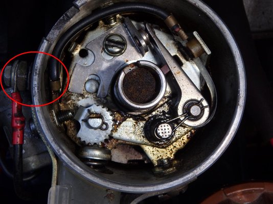

Noticed that sometimes spark is passing thru hole in dizzy where wires from cond and coil are conected.
Here
Get home and change that bolt with insulator from second dizzy that i have for parts (one i have taken of vacuum pump)
But this morning can not start car.
Spinning nicely bud nothing is happening.
Need to check spark.....
But it is strange as everything is as it was yesterday afternoon.
Find way wont start
There is no spark from coil ti distributor.
Changed coil but still no spark. Aldo not 100% sure second coil is good.
Can it be to condensator?
As i have noticed spark there yesterday.
Can it be that coil wont work because bad condensator?
How can i test is condensator good?

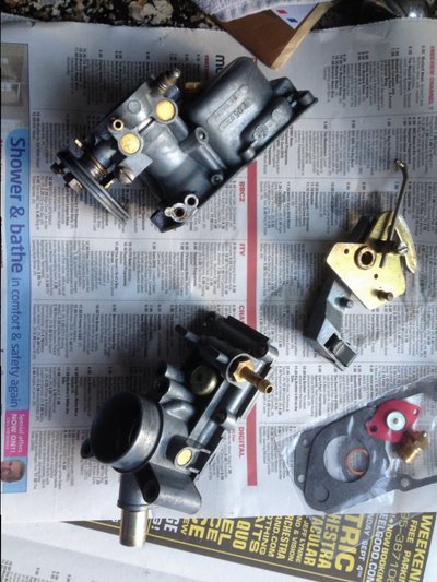

Did you have a little diaphram on your carburettors like in this photo bottom right (red)
It came with my repair kit for a Zenith 28F but I cant see where it goes?

That red diaphragm i did not find in my zenith.....
Searching for repair kit, find out there are few kits available for same carb (ZENITH 28IF) but i believe (did not investigate or know for a fact) they are for different sub-models of ZENITH 28 IF. Those additional numbers on side of carb body.
My kit did not even had diaphragm.
I have somewhere PDF file with pictures how to renew carb.....problem is that subtext is in Croatian......but pictures tell more.

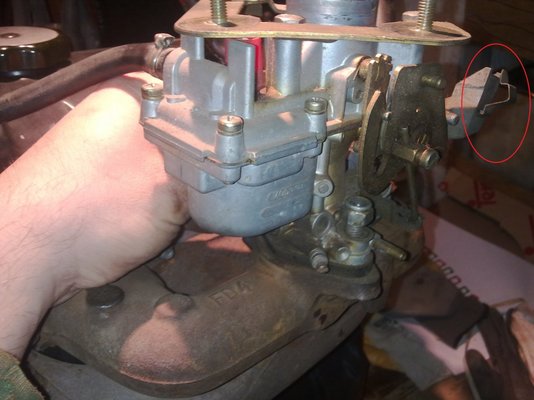

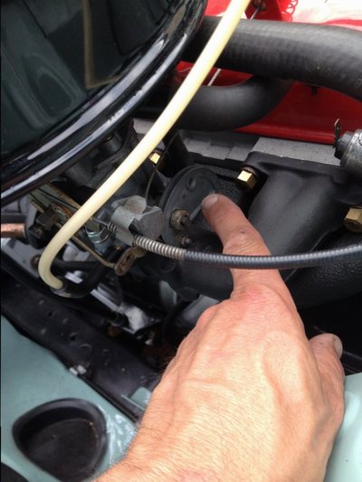

How does you choke cable stands on post on carb
Picture to see details
Hi Petak - not sure if this is your question but the little clip (circled in red on your photo) holds the choke cable outer. the post immediately to the left of the red circle is where the inner of the choke cable attaches with a small loop.

My question was awkwardly phrased
I was thinking for position of outer casing of choke cable in relation to holder....How many those small twists is towards carb from metal holder (or clip)
In one conversation gay mentioned to me that position of choke cable outer casing can be crucial for good operation of carb.
As i do not have picture ( among many that i have :ashamed:) i do not know how outer casing was positioned before.
Does really position of that outer casing maters in carb operation?
Hi Petak I don't think that it does matter as such as long as you have proper movement of the choke paddle when operating the choke I don't see the finite position of the outer matters. In any case it could vary on every car?
What is worth mentioning is the screw that clamps the rod is adjustable in that as you operate choke flap it opens the accelerator if it is set wrong it will tend to chug and not run cleanly 2or 3mmup or down will make a difference
If you go wrong way it will rev too high when ch oke pulled out

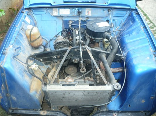

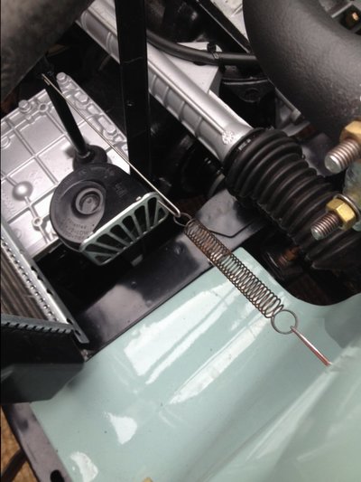

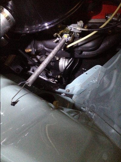

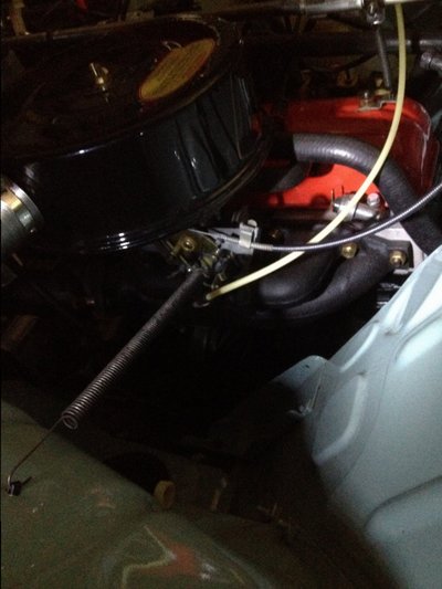

Hi Petak I'm putting my throttle cable back together this evening and realising there must be a spring missing that returns the crescent shaped cam back into position. Maybe it was that Spring I used on the gear shift? !
Your car is left hand drive so will be a little different. But where does the other end of the big Spring attach ?
Have I used the return Spring on the gear change ?
Correct answer☺ gear spring is shorter and attached to the downwards bracing bar
This goes from inner wing cross brace down to front chassis bumper bracket hole
Ther should be hole in inner wing high up level with carb

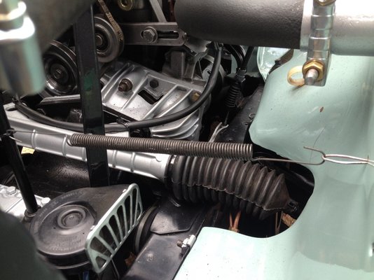

Yay sussed it (Sorry Petak for hijacking your thread you can delete if you wish)
This is what ive done....

Hello JonathanT...You got it right.....whole lot (spring and metal clip) you have put on gear lever goes in that hole on throttle cable "thing". Metal clip is put thru
inner wing same way you did for gear lever....
Just need to find right hole :D
Pictures
The carb spring is now where it should be. The gear change return spring is now on the top of the rocker box and a semi permanent spring is on the gear change. It should really be in the small hole on the vertical strut I see now Paul ;) thank you! But for the spring I had it works better like this.
