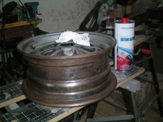

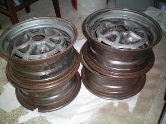

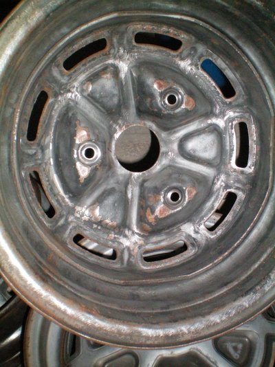

I am proceeding with my new wheels restoration...
Degreased with NaOH this evening, then I was suggested to sand with 400 paper, than wash with nitro, spray primer and then colour.
I bought a filler/primer spray can.
There is some rust on the wheels, nothing serious but diffused... I do not think I will remove it completely with sandpaper... The guy who sold me the primer said it is sufficient to remove the superficial rust, the firm rust is not a problem and will not come out of the primer.
I am quite diffident, and I am thinking of a first layer of rust converter, then a bit of sanding and after this the primer...
It is a good idea? I will waste my time because the shop guy was right? There is some kind of incompatibility between the rust converter and the primer?
Waiting for suggestions...

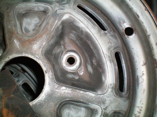

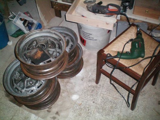

Mine is a more radical job, wheels are without tyres and the rear + shoulders are a bit more rusty tha the "face"...
Yesterday, as I said, the wheels were degreased, today I removed the great part of the rust (at least the superficial one) and not adhesive paint with a wire-brush mounted on my drill...
Tomorrow will be sandpaper day, I think...

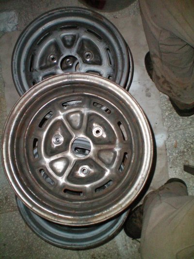

This evening maybe photos after NaOH, wire brush and sand paper...

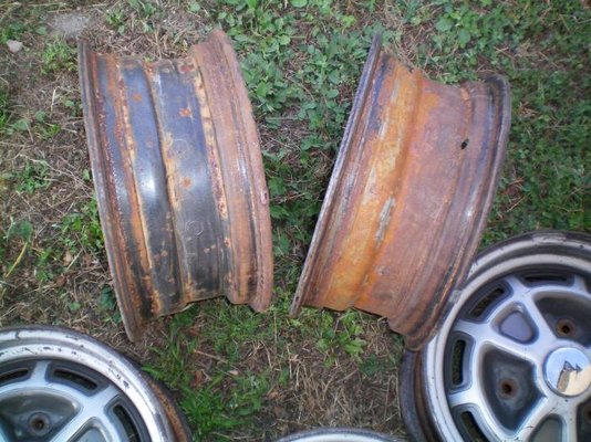

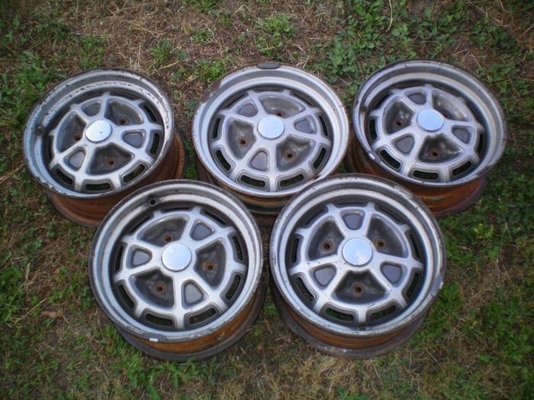

Just found out these beautiful wheels (one of the best for our little cars, on my own) on a used item site (subito.it is the italian equivalent of lbc, same graphic, access with same username and password...) for 80 euros... Quite a lucky guy I was.
I'd like to have them painted the same grey of the bumpers, and the darkest areas black (I will envolve my sister with a little brush, she's more inclined than me to this precision works).
I was even thinking of doing them white as the car, but maybe it will look a bit more "sporty"...
I should go downstairs in my garage to begin working, but it's raining and tis weather improves my natural idleness...
Found out tel. number of a sanding man, now I will ask for prices... But I do not want to spend more than a few tens euros...
Even time is important, too many times they will keep your wheels for weeks waiting to be prepared... and once they've done, you are in the hurry to coat them in primer, before rusting process begins another time...

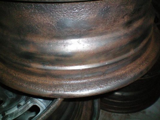

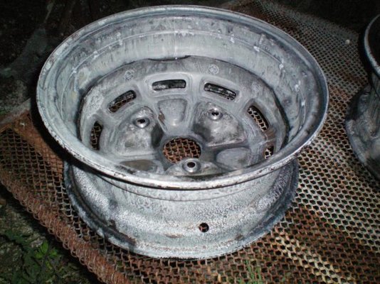

Alternative way: phosphating treatment. Now my rust is reacting with phosphoric acid in my garden, flowering on the surface as a white salt. I will wait about an hour, just a shower and dinner, then water abundantly with the garden hose. Tomorrow it will be dry and clean, ready to receive my primer...
Not satisfied at all by the phosphatic treatment: salt does not go away washing, rust appears where water stills... Brushed and sanded another time, less rust indeed, but I do not know if it is for the treatment or for the double sanding...

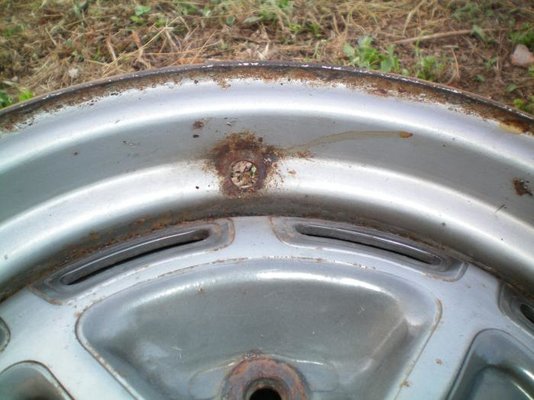

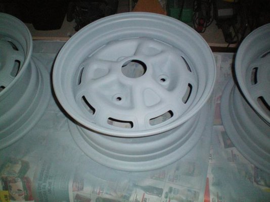

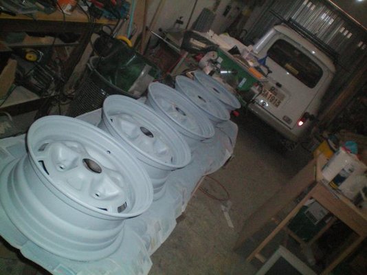

Today is "primer and filler day".
Tomorrow I will sand the primer with 800 grit sandpaper, then a coat of lucid black (RAL 9005) on the face, that will remain visible in the "cuttings"... Original color should be anthracite gray (RAL 7016, if I am right), but I prefer black because I think that, painting the wheel in stone grey (RAL 7030) the difference would be not impressive...
On monday the quest will be finding stone gray spray cans, in my town i visited an hardware shop, a paint shop and 2 brico centers and I did not find it...
I've been using a rust conversion phosphate treatment and also found a bit of excess salt and rust appearing after the washing. I found that drying the parts with towel after washing to blot up the water left over work well to stop rust coming back so soon. My stuff says you have to wash off the excess phosphate before it dries otherwise you get the white salt problem.
This was treated and left unpainted for several weeks in the middle of a wet winter here. No sign of rust returning so I'm happy with it.
