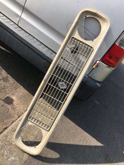

Afternoon Shakk
Not sure if attached is what your after ?
Regards
Hoof
