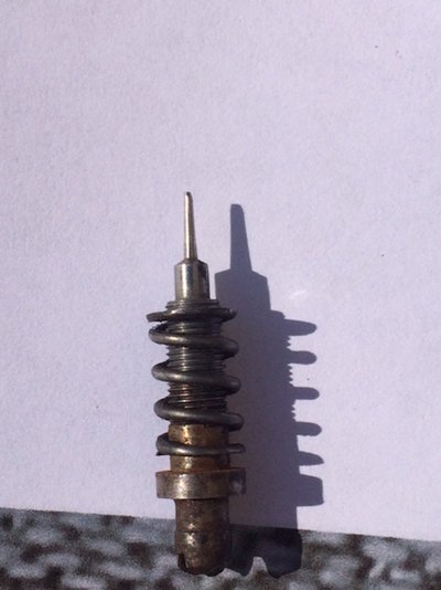

2 years ago, the MOT inspector overtightened my mixture screw and damaged the tip. I repaired it with fine sandpaper and its OK now. At the time I sourced a new one at all4renault but as it was over 40Euro I didn't buy it.
Interesting Mojobaby, the mixture screw on mine has been overtightened at some stage, the tip looks flatish ( always has, thought I sourced replacement but was incorrect upon arrival) looking at your video is the point a small (appox 45’) cone, pausing video to check that but confirmation before attempting home repair would be appreciated.
Hello laxeian, the tip of the mixture screw is needle nose shape. I think that the cone shape that you're talking about is the female side and it's fixed into the wall of the carb. Have a look at Mario's photo on page 3.
I think that my needle was probably bent and when the MOT guy screwed it in tighter, the tip might have connected with the side of the hole and caused damage to the point.
When I scratched the point with my fingernail, there was definitely a hook on the tip. I sanded it flat with 1000 grit sandpaper.
This is what it looks like now but I think its supposed to be sharper

Could feel a slight burr at tip end, so I’ve repeated your above advice. Photo would be a duplicate of yours.
Possibly over cautious on my part before cracking on, turned in for last ITV with existing screw (from 2.5 turns to 1, just prior to test centre) and it sailed through, but to be sure is to be sure.
Will say that after cleaning and following whats above it does seem to be ticking over smoother, been able to knock the tickover speed adjustment back a 1/4 of a turn, on a quick warmed up run its made the exhaust note smoother when deaccelerating in gears ( exact same route ), top stuff, Thanks

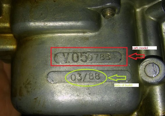

Perhaps the collective knowledge on the forum can help my confusion: I bought a carb repair kit for the 28IF as per link www.franzose.de/en/Renault/Alle/Vergaser-Vergaserdichtsaetze/ANR82872/ Note the shape of the diaphragm. Which is different to the one I found on dismantling my carb (diaphragm of which was square). When I went back to Franzose website to check if I'd got the wrong kit (apparently not), I saw that you can buy the diaphragm which I have in my carb at this link www.franzose.de/en/Renault/Alle/Vergaser-Vergaserdichtsaetze/ANR82862/ which it says is also for a Zenith 28IF - but doesn't come in the 28IF kit which I bought.
Am I going mad, or is there more than one type of Zenith 28IF?

There are many Zenith 28IF carburetors with smaller and bigger differences
On this picture you can find model number according which you can identify your carb and at which car (engine) it was intended to be mounted.

So you need to identify your carb and see what are factory details for it.
Thank you Petak, much appreciated. Thanks also for your photos further up this thread (photos of pilot holes). The side ones on mine were blocked. If anyone would like (at no cost) the diaphragm as per first link in my post above, please let me know and I'll happily put it in an envelope and send it to you.
