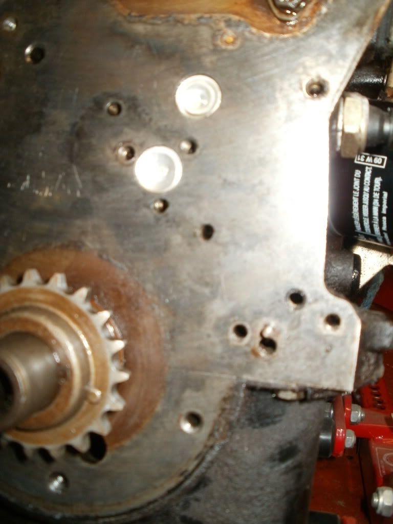

Decided the best thing to do was bite the bullet and take the engine out to have a look at the tensioner, what I found wasn't great. It was the clockwork spring type, and yes, it's foofoo'd . Do you think the best bet is to try Renault dealers to get the part?, or perhaps I should say the modified part as Mr Reno says there is a modification kit for this type of (crap) tendioner. Anyone have one laying around looking for a new home?. Is it possible to fit the older and obviously better type?.

Here's what I found. Had a look on the Interweb and the Renault 5/9/traffic tensioner looks very similar with a slightly longer arm, I wonder if this is the modified arrangement Mr Reno is talking about?. I'm eager to see what Mr Reno has in his van of tricks, but if it doesn't turn out to be the right one I might try the R5 one. Does anyone know if the hydraulic tensioner can be retro fitted to my engine?. The back plate looks like it doesn't have enough holes, but I wonder if the block drillings are the same and the backplate can be drilled to suit and the hydraulic tensioner fitted?. I've got a new chain, but I see the French specialist has a timing chain kit for 74 euros or so. Sprockets, chain and tensioner.

Is there a chance somebody fitted the wrong chain tensioner? No matter if a tensioner design is good or bad, this should never happen!
Mr Reno, Paul, is the expert, according to him Renault fitted this tensioner only for one year, 1976, then changed back to the previous design, for what is now an obvious reason. I guess they must have saved money in the production process?. As I said, I'll see what Paul has laying around, I'll get something sorted out, Normandy in 5 weeks, I had better!
Alan.
Well, here's the state of play so far, as you can see from the pictures there's no shortage of holes, so I think I should be able to fit a new style tensioner if that's what Paul has. Can't figure out how the oil flows from where the filter is meant to be (lower shiney plug) to the tensioner, does the plate I see in the drawings have a groove machined in the back of it to allow oil to flow to the tensioner?. There's no hole in that shiney plug?. The only through hole is the one with the pin above it where the spring type tensioner was mounted, looks like it goes back nto the crankcase. I'll have to drill holes in the back plate anyway to mount the tensioner, there's only one, and that's the hole where the pin is located.

patience patience all will be revealed tommorow think there is a backplate and hydraulic tensioner in kit
