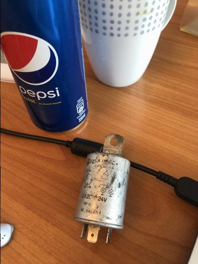

Can I use 24v appliances in a R4 that is based on a 12v system??

I wouldn't have thought so, as the voltage will be too low to switch the circuit from one side to the other. Worth trying, though, just to see...........
I tried this flasher (24V), it didn't work. Problem, now it doesn't work with the previous flasher!
help please... :doh:
With only half the voltage supplied the amp draw doubles . Maybe you only fried a fuse. Not likely but possible.
@Crelesy correct diagnosis.

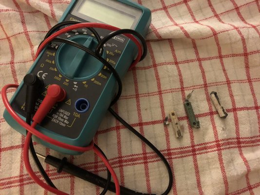

Fuse has blown. 2 more after.. now with 12V flasher.
reason??

What kind of short could cause these problems?
I disassembled flasher relay.. i tried to repair, maybe I damage something.
I have to replace it.
Maybe flasher fried...
Should check wiring now first. If there is some bad contact or some other resistance somewhere you are operating the flasher with lower voltage or higher load. Thus more amps again. Or the flasher is yust fried or incorrectly wired.
At mine '75 the wiring goes via the warning switch. If something is wrong over there every thing goes wrong. Don't know about newer ones.
Beep the wires and check for shorted wires.. its a bit difficult to diagnose from a distance...
