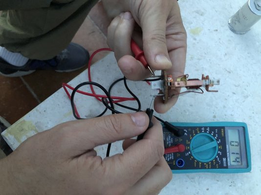

perhaps the relay is touching the case..
continuity check, I have result in a loud beep..two pin (L & X) are electrically connected.
is it correct??

That's correct. But there must be some risistance for it is a spool.

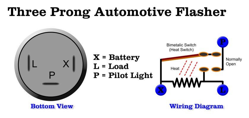

X is +, L is load(to the indicator switch and then to the actual lightbulbs and P is for the dashlight. X could allso come from the emergency lights switch. ( Still a +)
I don't know your years scematics...
I suspect your fuse blowing problem is because the bimetallic strip is touching the metal casing of the unit, thus earthing the 12 volts from terminal "X" & therefore blowing the fuse. You might be able to rearrange this, by g-e-n-t-l-y bending the strip a little away from the case, and using your meter to check there's no longer a dead short.
no short circuit, i checked it (tested with a multimeter, case and L or X between pair of probes - not connected).. thanks anyway @Andrew4Renaults ..
I must check contact resistance to diagnose relay problems. Anywhere from 50-120 ohms is OK?

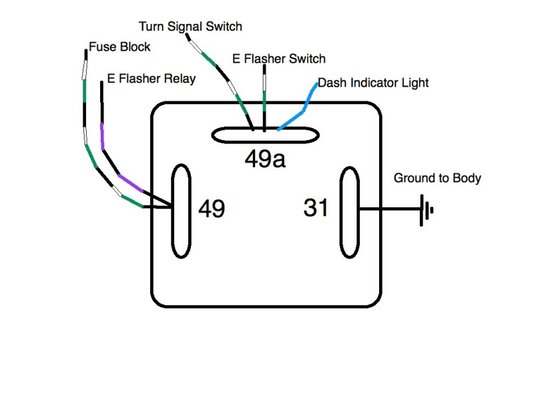

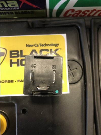

Replacing old flasher unit with modern relay?
this one is available in stores, 3.5EUR.
This one ought to work properly. Connect the 49 terminal to the fused feed, the 31 to a good earth & the 49a to the indicator switch and it ought to work perfectly!
This flasher unit is mainly for VW cars with a different flasher / switch layout. You won't have indicator light by using this flasher unit, plus, you have to modify the plug. The "L - P - X" type is extremely popular and used on almost all cars, I wonder why you can't find it in your country.

If bimetallic strip is touching the case and shorting out when in use, testing it when disconnected may not show the short.
